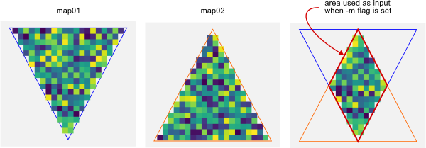

If any of the input maps include NODATA cells, these should normally not be included. To ensure this, the -m flag can be set to remove them. This mimics the default behaviour of the nicheOverlap function in the R dismo package. Depending on what the NODATA represents, an alternative approcah is to replace the NODATA with 0 values before running r.niche.overlap.
Figure: with the -m flag set, areas with NODATA in any of the input maps are ignored.
