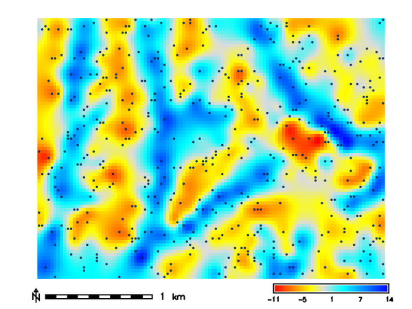

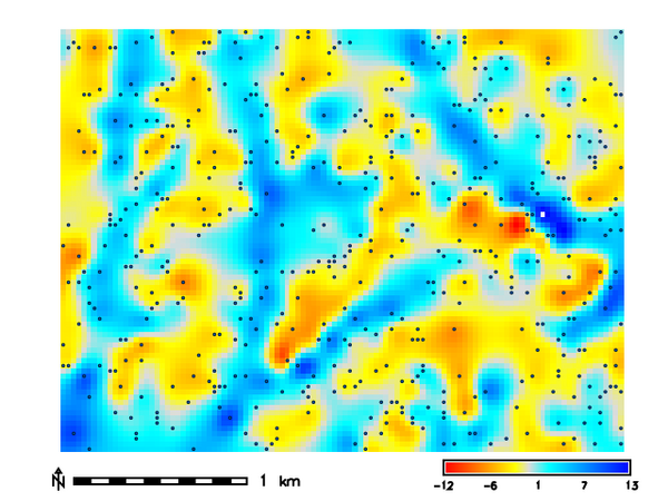

When the cv_prefix option is set, the vector point maps with the cross-validation results will be saved and interpolated into a new surface that displays the residuals of the cross-validation. The surface will be saved in the current mapset with the name <cv_prefix>_<tension>_<smooth>.
cdev-surface
Tension: 100 Smooth: 0.5 cdev-surface
Tension: 100 Smooth: 5 cdev-surface
Tension: 10 Smooth: 0.5 cdev-surface
Tension: 10 Smooth: 5
