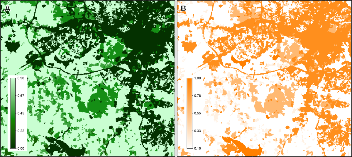

The original land use map and the derived friction and suitability maps are shown in the figure below.
image-alt
Figure 1: The A) friction and B) suitability maps, based on scores assigned to each land use category of the landuse map.
