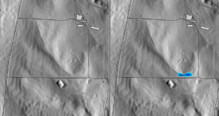

EXAMPLE
Example of small flooding along a street (North Carolina sample dataset):
g.region raster=elev_lid792_1m -p
# water accumulation next to street dam
r.lake elev_lid792_1m coordinates=638759.3,220264.1 water_level=113.4 lake=flooding
# draw resulting lake map over shaded terrain map
r.relief input=elev_lid792_1m output=elev_lid792_1m_shade
d.rast elev_lid792_1m_shade
d.rast flooding
d.vect streets_wake
Small flooding along a street
Small flooding along a street (r.lake, using Lidar 1m DEM)
