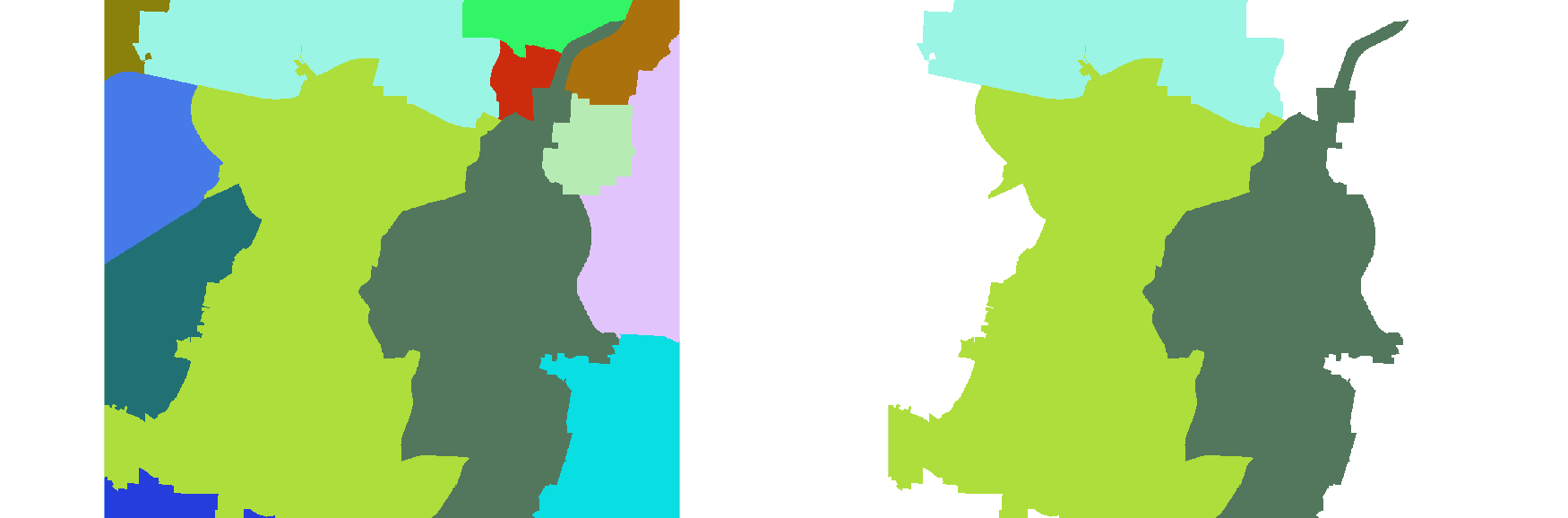

In this example, the ZIP code map in the North Carolina sample dataset is filtered for large areas (removing smaller areas from the map).
g.region raster=zipcodes -p
r.report zipcodes unit=h
Extract only areas greater than 2000 ha, NULL otherwise:
r.reclass.area input=zipcodes output=zipcodes_larger2000ha lower=2000
r.report zipcodes_larger2000ha unit=h
Figure: r.reclass.area method=reclass
