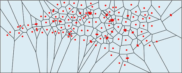

Voronoi diagram for points
This example uses the hospitals in the North Carolina dataset.
g.region -p raster=elev_state_500m
v.voronoi input=hospitals output=hospitals_voronoi
Result:
Voronoi diagram for hospitals in North Carolina

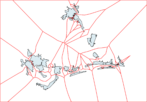

Voronoi diagram for areas
This example uses urban areas in the North Carolina dataset.
g.region -p n=162500 s=80000 w=727000 e=846000 res=500
v.voronoi input=urbanarea output=urbanarea_voronoi -a
Result:
Voronoi diagram for urban areas in North Carolina

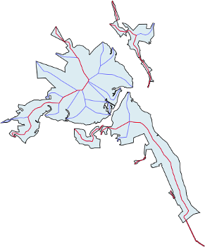

Skeletons and center lines of areas
g.region -p n=161000 s=135500 w=768500 e=805500 res=500
v.voronoi input=urbanarea output=urbanarea_centerline -s
v.voronoi input=urbanarea output=urbanarea_skeleton -s thin=2000
Result:
Skeleton and center line for urban areas in North Carolina
Skeleton (blue) and center line (red) for urban areas in North Carolina
