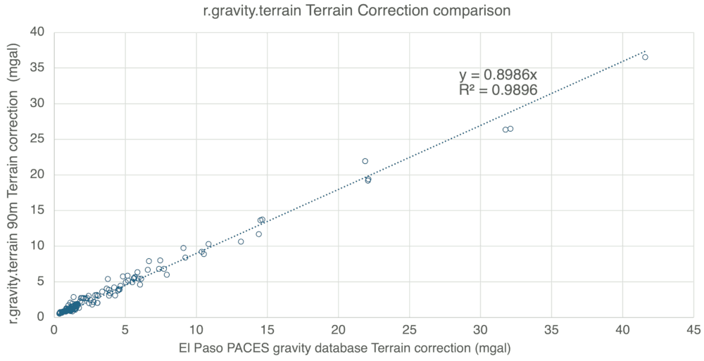

Figure 1: This is an example of a gravity terrain correction calculated out to 30km from the measurement site (located in the Sangre de Cristo Mountains / Spanish Peaks of Colorado). This tool does not output the above raster, but instead it is a visualization of an intermediate calculation product. The terrain correction value at each DEM pixel is summed and then output in this tool. The color scale shows gravity terrain correction values of individual pixels in mgal. For the above gravity point, the total terrain correction is 8.56 mgal for an n of 3,0163,432 cells.
r_gravity_terrain example
Figure 2: Above is a comparison of the terrain correction output of this tool with values from the El Paso PACES gravity database downloaded in 2015 using 90m SRTM DEM data out to 167 km. The dataset is 131 gravity points from the Sangre de Cristo Mountains and Raton basin of Colorado. There is a strong linear correlation between the two correction techniques (R^2 of 0.989), but the one used here outputs somewhat smaller values at high terrain correction magnitudes. However, this could also be due to the small number of points with terrain correction values greater than 20 mgal.
