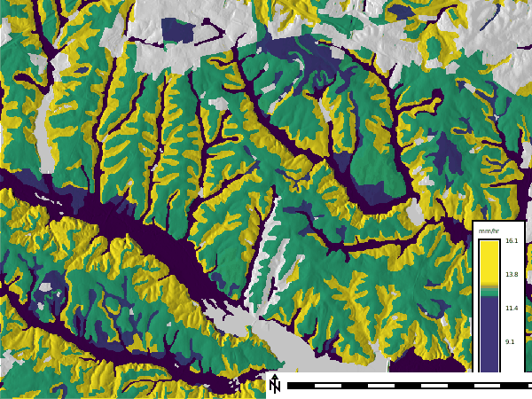

ROSETTA saturated hydraulic conductivity
Figure: ROSETTA-estimated saturated hydraulic conductivity (mm/hr) from SSURGO texture and bulk density over shaded relief (NC sample dataset, Lake Wheeler area). Low-conductivity alluvial soils trace the drainage network; gray areas are map units without soil data.

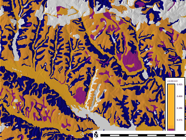

ROSETTA saturated water content
Figure: ROSETTA-estimated saturated water content theta_s (cm3/cm3) for the same area.
