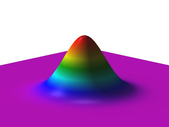

Create a simple Gaussian bell
r.surf.volcano -r output=seamount method=gaussian
# view in the display monitor
r.colors seamount color=roygbiv
d.rast seamount
# render in 3D
m.nviz.image elevation_map=seamount out=gaussian \
  perspective=10 resolution_fine=1 height=3500
# export to Matlab
r.out.mat in=seamount out=seamount.mat
# integrate into existing DEM
r.mapcalc "seamount_dem = if(seamount > dem, seamount, dem)"
r.colors seamount_dem color=srtm
image-alt Gaussian bell

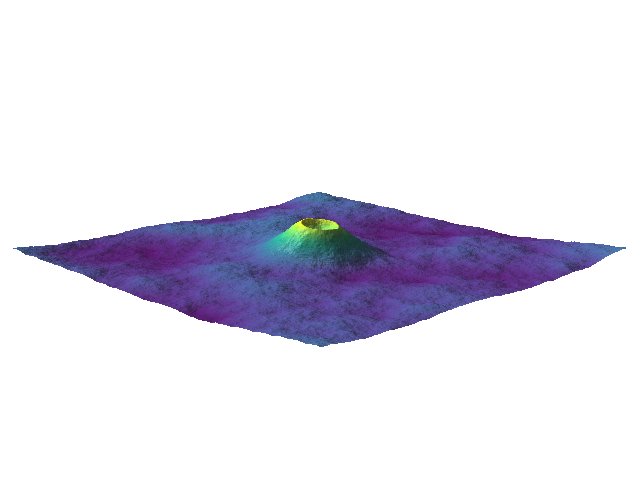

Create a fancy 3D scene
r.surf.volcano -r output=base_volcano peak=1000 crater=200
r.surf.fractal output=base_fractal
r.mapcalc "artificial_land = base_volcano*3.5 + base_fractal"
m.nviz.image elevation_map=artificial_land out=volcano3D \
  perspective=25 resolution_fine=1 height=30000
image-alt Synthetic volcano from r.surf.volcano combined with fractal landscape from r.surf.fractal
