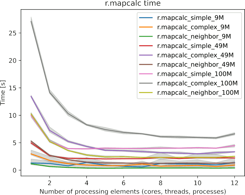

r.mapcalc is parallelized using OpenMP. The number of threads can be controlled with the nprocs parameter. Note that more complex expressions can benefit from more threads. By default (nprocs=0), r.mapcalc uses all available threads. Use the --verbose flag to display the number of threads in use. If you observe reduced performance when using many threads, try lowering ther number.
Note: r.mapcalc may disable parallelization in certain cases, even when requested:
- When a mask is active, because the current parallel implementation does not support it.
- When the rand() function is used, to ensure reproducible results.
Figure: Benchmark shows execution time for different number of cells
and different complexity of expressions.
See benchmark script in the source code.
(Intel Core i9-10940X CPU @ 3.30GHz x 28)
