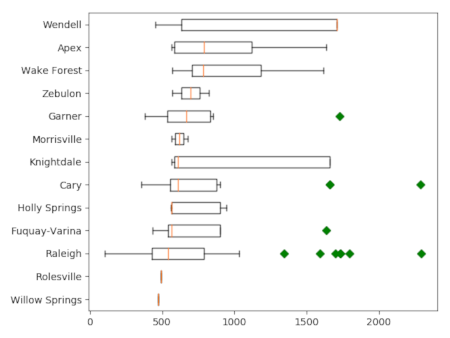

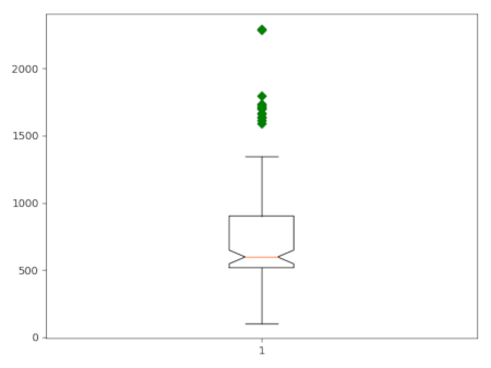

DESCRIPTION
The v.boxplot module draws a boxplot of the values in a vector map attribute column. Users can use the where option to select a subset of the attribute table. Values in the column can also be grouped according to the categories in another column (group_by), creating separate boxplots for each group.
Appearance
Options to customize the appearance of the plot include rotating the plot and x-axis labels, adding notches, removing outliers, and defining the colors of various boxplot components. By default, the resulting plot is displayed on the screen. However, users can save the plot to a file by specifying the desired width, height, and resolution. The format of the saved file is determined by the provided file extension. For example, if plot_output = outputfile.png, the plot will be saved as a PNG file.
Outlier map
Setting outliers_map creates a vector map with only features whose column value is a boxplot outlier. With group_by, outliers are computed separately per group. The output keeps the original attributes and adds:
  • side: low or high outlier.
  • iqr_dist: signed distance beyond the relevant fence, in IQR units.
  • n_overlap: number of other groups whose value range contains the outlier.
  • GRASSRGB: color string; high outliers are red, low outliers blue. More exceptional values are darker and more saturated.
overlap_basis defines the comparison range. With whisker, outliers are compared with other groups’ non-outlier range, between fences. With box, they are only compared with other groups’ interquartile range, Q1–Q3.
n_overlap is the number of other groups whose value range contains the outlier’s value. It distinguishes outliers that are exceptional relative to all groups (n_overlap = 0) from those that are unusual only within their own group (n_overlap > 0). For predicted classes, n_overlap > 0 marks features that may be difficult to classify because their values are typical of one or more other classes. In contrast, n_overlap = 0 marks values distinct from every other class. Mapping n_overlap therefore shows where class ambiguity is geographically concentrated.

Example 1
Use the vector layer schools_wake from the NC sample dataset to create boxplots of the core capacity of schools in Wake County, North Carolina. Use the Where clause to exclude all records with no data. Use the -o flag to draw outliers.
v.boxplot -n -o map=schools_wake column=CORECAPACI where="CORECAPACI >0"
image-alt
Figure 1: Boxplot of core capacity of schools in Wake County.

Use the vector layer schools_wake from the NC sample dataset to create boxplots of the core capacity of the schools in Wake County, North Carolina, grouped by city. Use the Where clause to exclude all records with missing data. Use the -o flag to draw outliers.
v.boxplot -h -o map=schools_wake column=CORECAPACI where="CORECAPACI >0" group_by=ADDRCITY order=ascending
image-alt
Figure 2: Boxplot of core capacity of schools in Wake County, grouped by city.
