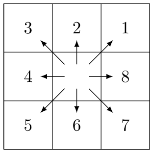

drainage=name
    Name for output drainage direction raster map
    Directions numbered from 1 to 8

drainage : str, optional
    Used as: output, raster, name

Output drainage raster map contains drainage direction. Provides the "aspect" for each cell measured CCW from East.
drainage
Figure: Drainage is 8 directions numbered counter-clockwise starting from 1 in north-east direction (source)
Multiplying positive values by 45 will give the direction in degrees that the surface runoff will travel from that cell. The value 0 (zero) indicates that the cell is a depression area (defined by the depression input map). Negative values indicate that surface runoff is leaving the boundaries of the current geographic region. The absolute value of these negative cells indicates the direction of flow. For MFD, drainage indicates the direction of maximum flow.

Given that the drainage is 8 directions numbered counter-clockwise starting from 1 in north-east direction, multiplying the output by 45 (by 45. to get a double precision floating point raster map in r.mapcalc) gives the directions in degrees. For most applications, zeros which indicate depressions specified by depression and negative values which indicate runoff leaving the region should be replaced by NULL (null() in r.mapcalc). The following command performs these replacements:
r.mapcalc "drainage_degrees = if(drainage > 0, 45. * drainage, null())"
Alternatively, the user can use the -a flag or later the abs() function in r.mapcalc if the runoff is leaving the region.
