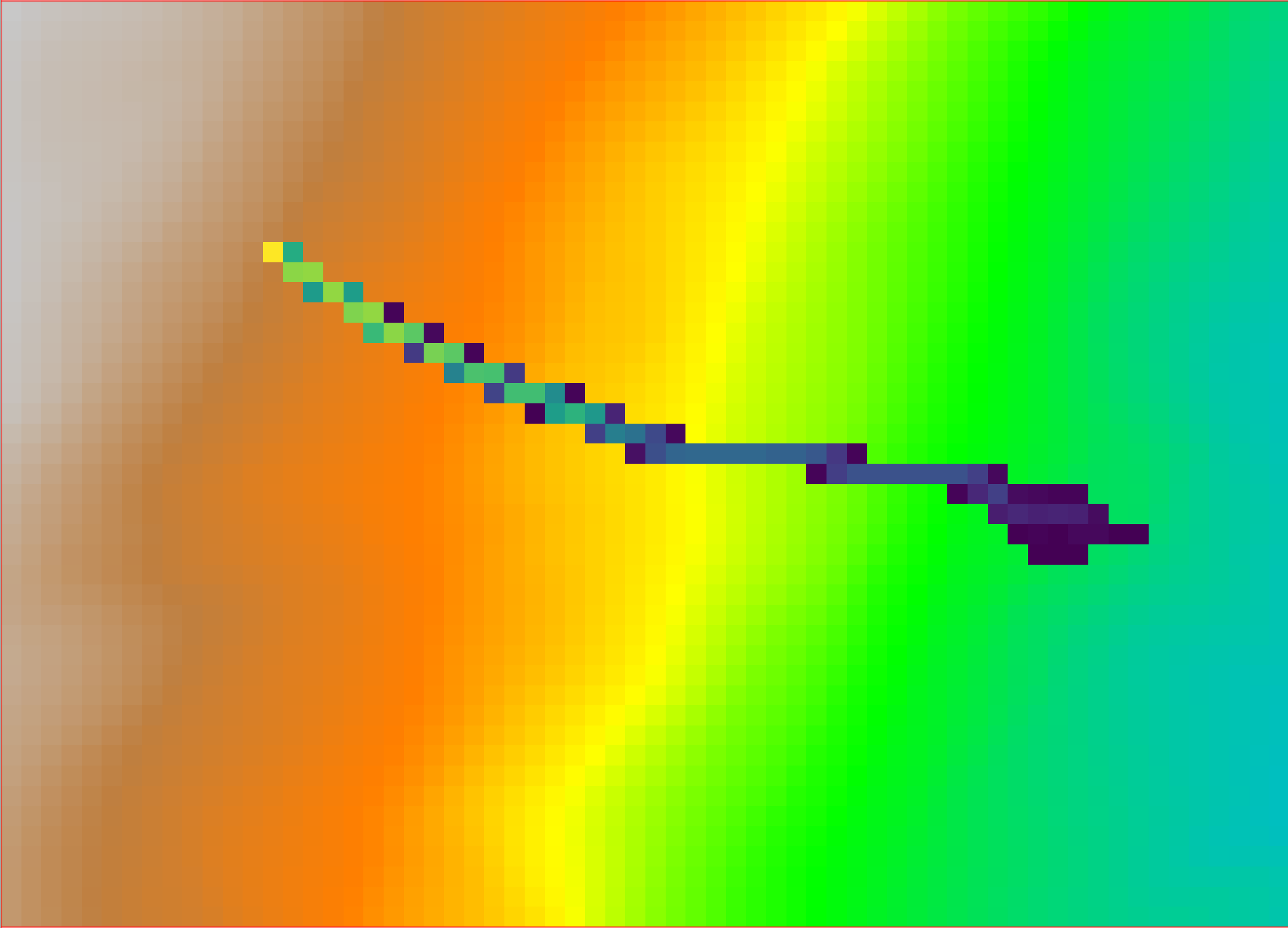

The following figures show the output of the r.stone module, initialized with an individual source point.
A sample portion of a 10m x 10m resolution DEM, with one grid cell (red square) acting as a rockfall source point, with raster value 100: the effect on the model r.stone is to simulate 100 trajectories starting from that cell.
Sample output of r.stone, depicting the counter raster map; the values of the raster output correspond to the total number of simulated trajectories going through that cell.
